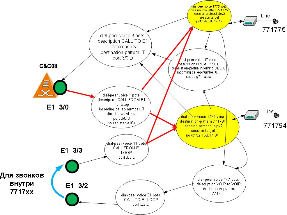

И вот мой рабочий конфиг
Спасибо за http://subnets.ru/blog/?p=1239
voice-port 3/0:D
 disc_pi_off
 no non-linear
 no vad
 no comfort-noise
 cptone RU
 timeouts call-disconnect 3
 threshold noise -90
voice-port 3/1:D
 disc_pi_off
 echo-cancel coverage 24
 no comfort-noise
 cptone RU
 threshold noise -90
voice-port 3/3:D
 disc_pi_off
 no non-linear
 no vad
 no comfort-noise
 cptone RU
 threshold noise -90
voice-port 3/2:D
 disc_pi_off
 no non-linear
 no vad
 no comfort-noise
 cptone RU
 threshold noise -90
dial-peer voice 1 pots
 description CALL FROM E1
 translation-profile incoming DEL_7722
 huntstop
 incoming called-number .T
 direct-inward-dial
 port 3/0:D
 no register e164
dial-peer voice 3 pots
 description CALL TO E1
 preference 3
 destination-pattern .T
 port 3/0:D
dial-peer voice 47 voip
 description FROM IP NET
 translation-profile incoming DEL_8
 incoming called-number 8.T
 codec g711alaw
dial-peer voice 1775 voip
 translation-profile incoming CUT-PREFIX
 max-conn 2
 destination-pattern 771775
 progress_ind setup enable 3
 progress_ind progress enable 8
 session protocol sipv2
 session target ipv4:192.168.17.75
 session transport udp
 dtmf-relay rtp-nte
 codec g711alaw
 fax-relay ecm disable
 no vad
dial-peer voice 1794 voip
 translation-profile incoming CUT_PREFIX
 max-conn 2
 destination-pattern 771794
 session target ipv4:192.168.17.94
 dtmf-relay rtp-nte
 codec g711alaw
 no vad
codec g711alaw
 no vad
dial-peer voice 31 pots
 description CALL TO E1 LOOP
 direct-inward-dial
 port 3/2:D
 no register e164
dial-peer voice 11 pots
 description CALL FROM E1 LOOP
 direct-inward-dial
 port 3/3:D
 no register e164
dial-peer voice 147 voip
 voice cut-through alert
 description VOIP TO VOIP
 destination-pattern 7717.T
 codec g711alaw
controller E1 3/0
 framing NO-CRC4
 pri-group timeslots 1-31
 description HUAWEI  7717xx
controller E1 3/1
 framing NO-CRC4
 description 2 POTOK PRI
controller E1 3/2
 framing NO-CRC4
 description LOOP 7717xx
controller E1 3/3
 framing NO-CRC4

Готов выслушать Ваши мнения и предложения
Пойду про Asterisk читать....... :) :) :)
так у меня работает
